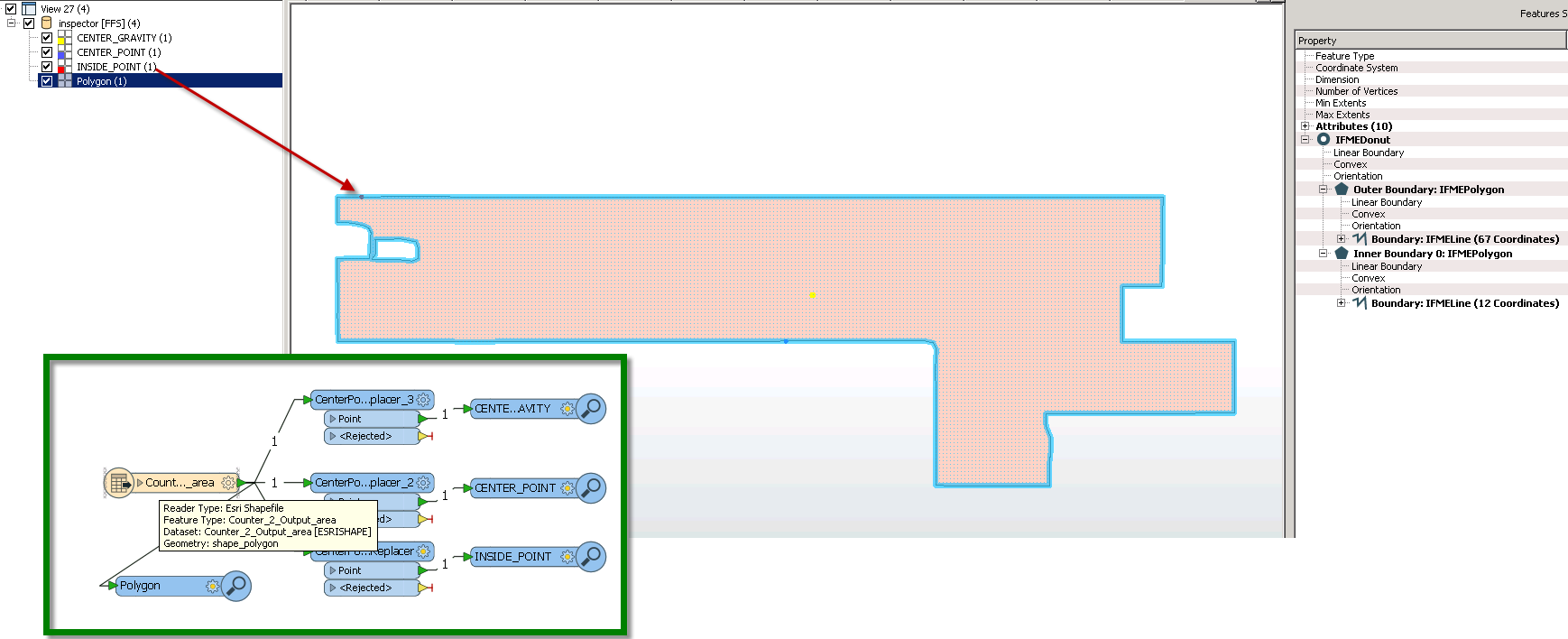

It's been a while since I've been working with this FME Desktop transformer. Today, I found something that woke me up and made me think HOW the "Inside Point" feature (one of the three options) is generated using this transformer. The situation is this one:
Input: One polygon feature from a Shapefile.
Using FME Desktop 2016.1 (tried older versions and same results)
Image:
I don't know if you can appreciate that the INSIDE POINT generated is in the same border of the polygon, so, after that, if I try to "Overlay" with other transformers like PointOnAreaOverlayer... it'd give me a non-overlay output.
After all this description, I wanted to know "How" is generated this "point" output using the CenterPointReplacer transformer:
  • Is there any potential parameters as could be Bounding Box, Number of coordinates, Multipatch feature... to be considered?
Knowing that information, I could anticipate these situations and get it ready before hand with any workaround, instead of figuring out why my workflow is not working properly and finding out these special cases.

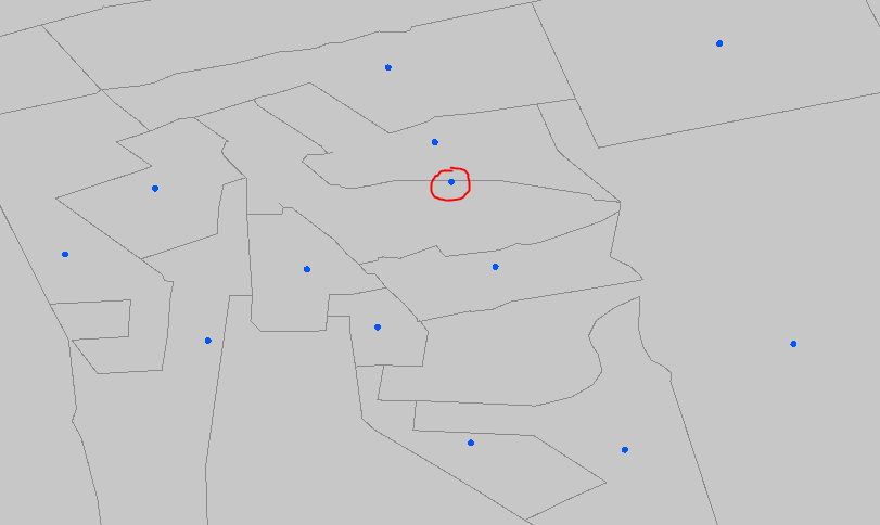

I came back to this topic, just to see any progress on this... just found another example (CenterPoint falling on the edge, topologically touching its neighbor :( ):
Any suggestions? Thanks,

This is indeed a known issue for odd-shaped geometries, it's mentioned in the documentation that I've linked below.
For your case a possible solution would be to set mode to "Inside point", which will return a point that's guaranteed to be inside the polygon. It's slightly slower, however.

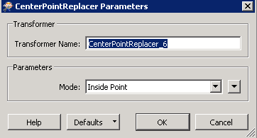

Thanks David, indeed, is already set to INSIDE Point:
Looks like we'd need a "Really INSIDE Point" option there... ;)

100% is on the edge, which causes me issues giving me back instead the neighbors info...
david_r
  • Apr 5, 2018 2:38 PM UTC
Sounds like an interesting edge case. I recommend you send a sample dataset and workspace to Safe support so that they can have a look.
