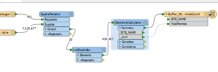

Hi there,

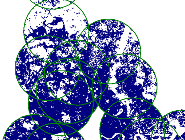

I wonder anyone can help me on my query. I have a Point dataset and a Polygon Dataset they on ESRI file Geodatabase format.
I have over 700 circles and 7million Points
Point Data contain Premise Count , so I will require to sum up all Premises by each Circle and assign that number to each circle, including overlapping
I have used Spatial Relater/Spatial Filter/Clipper none of them give me the correct answer.
Let me know if this can be done using FME
thanks,
Regards,
Pushpa

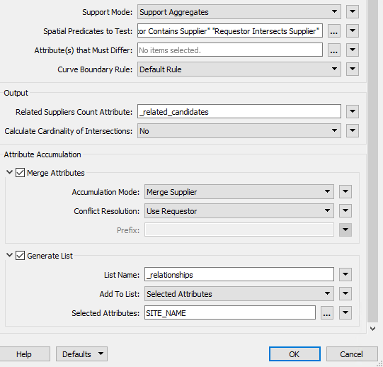

Initial thoughts are you want the Spatial Relator,but you need to build a list and then explode it before summing to get the correct answer

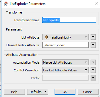

If your points are the requestors and the circles your suppliers, test for "requestor is within supplier". Then under Attribute Accumulation tick generate list and select whatever unique identifier you have for the circles. Then use a listexploder to explode the list (be deafult it will be called _relationships) just created and sum based on your circle unique identifier.
