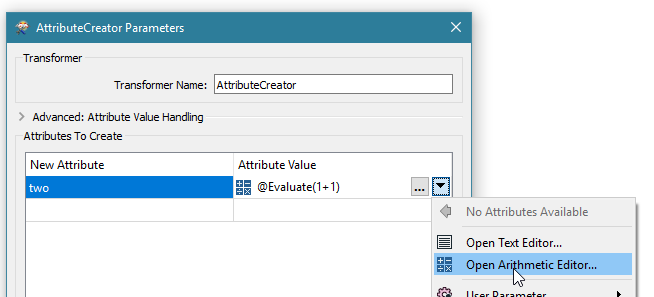

I am new to FME, so please accept my apology if my question sounds too simple or stupid. I want to calculate two new attributes. Both attributes have different calculations. I am using Expression Evaluator. I can only calculate one attribute. For another attribute, I couldn't find any option to calculate another attribute. Am I supposed to use a new expression evaluator for another attribute? or is there any other way to calculate the new attribute?

Yes, either use a separate ExpressionEvaluator for each attribute calculating, or use something like an AttributeCreator / AttributeManager and embed the expressions there using the arithmetic editor:
