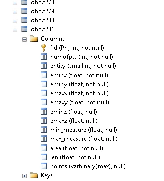

Hello, I have a BLOB field, it is supposedly multiple points that form a polyline, but I cannot export the blob into a usable geometry. I have tried GeometryReplacer and GeometryExtractor but I have not been able to get usable results. I attached an excel file with the BLOBs

It is varbinary(max)

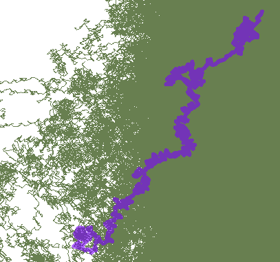

The only way I was able to get the GeometryReplacer to return anything else than an error was by first removing the "0x" prefix and treat it like a QlikMaps Encoded Polyline. However the result doesn't make much sense (to me):
I think the key here is to know how the geometry is encoded in the blob, or at the very least know which software is used to manipulate it.

Thanks! It looks like after all that there doesn't seem to be much useable data in there at all, or its something that ESRI doesn't want to show us!
