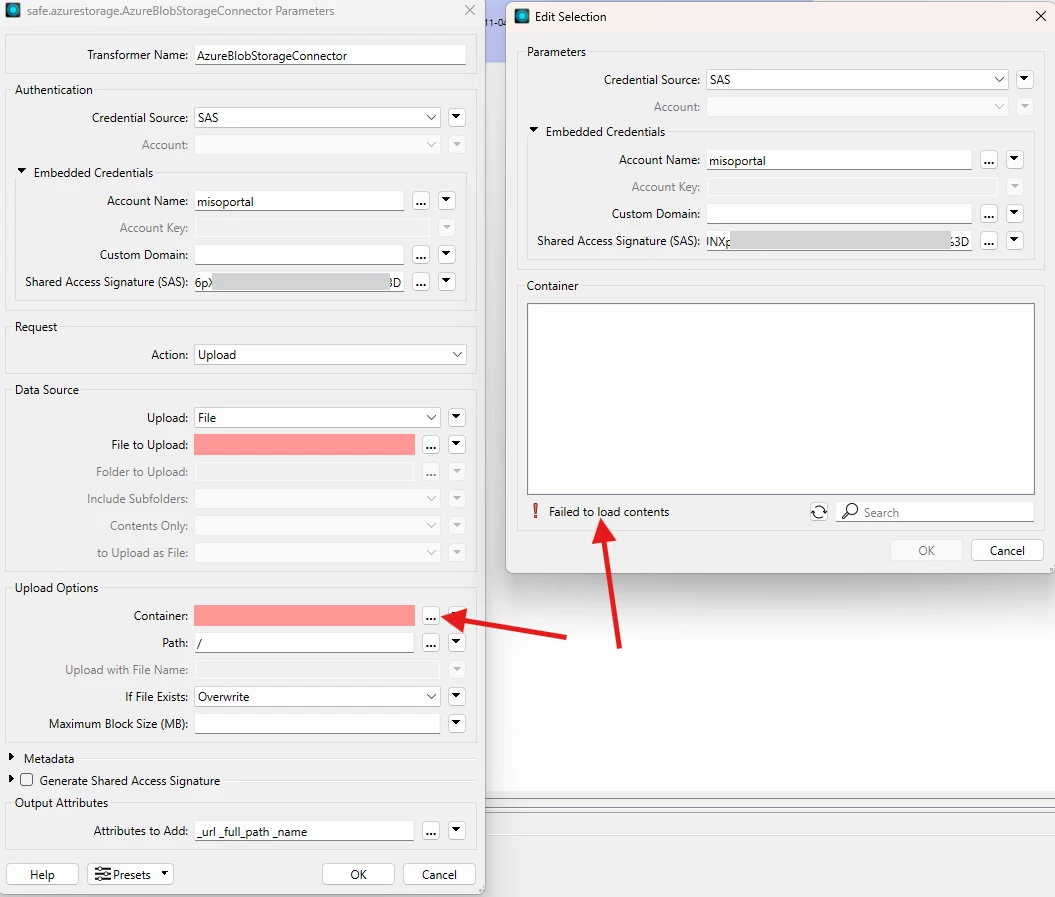

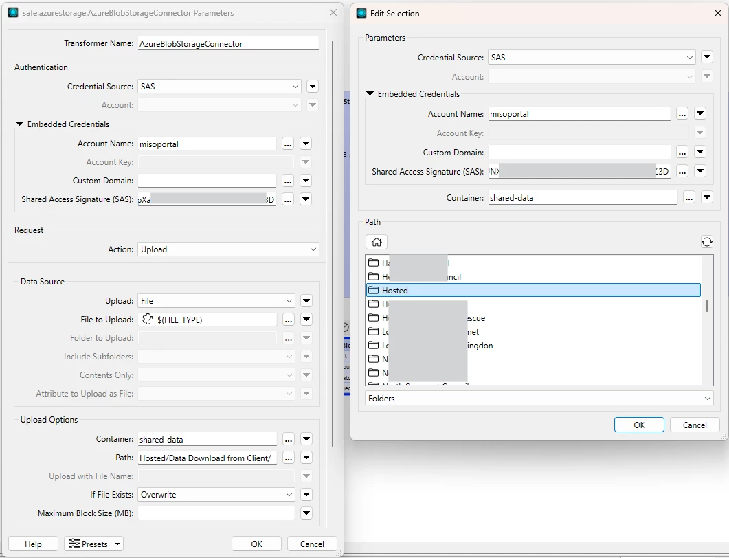

I’ve successfully connected to the Azure BLOb using 2025.1 Form using the AzureBlobStorage Connector:
I can connect to the “Hosted” folder inside the container “shared-data”. I am connecting using SAS.
However, I need to use Flow 2024.2 and so I need to open this same workbench in Form 2024.2…. and this is where the fun starts!
The transformer is slightly different, when I try to configure the Container I don’t seem to have the option to add the “Shared-data”.
I am a complete novice at connecting to Azure, so please do not worry about over-explaining anything, I need all the help I can get!

The change we had as users was to switch from a laptop / machine login to a Windows / 365 Account login. Why this would affect connections to Azure I am unsure, but it did!
Whilst I still cannot connect from 2024.2 Form on my laptop to the BLOb store, I can connect on 2025.1 and .2, so that is unchanged.
I can however, use 2024.2 on an Azure VM to connect to the BLOb store, which is the main game here for me.
