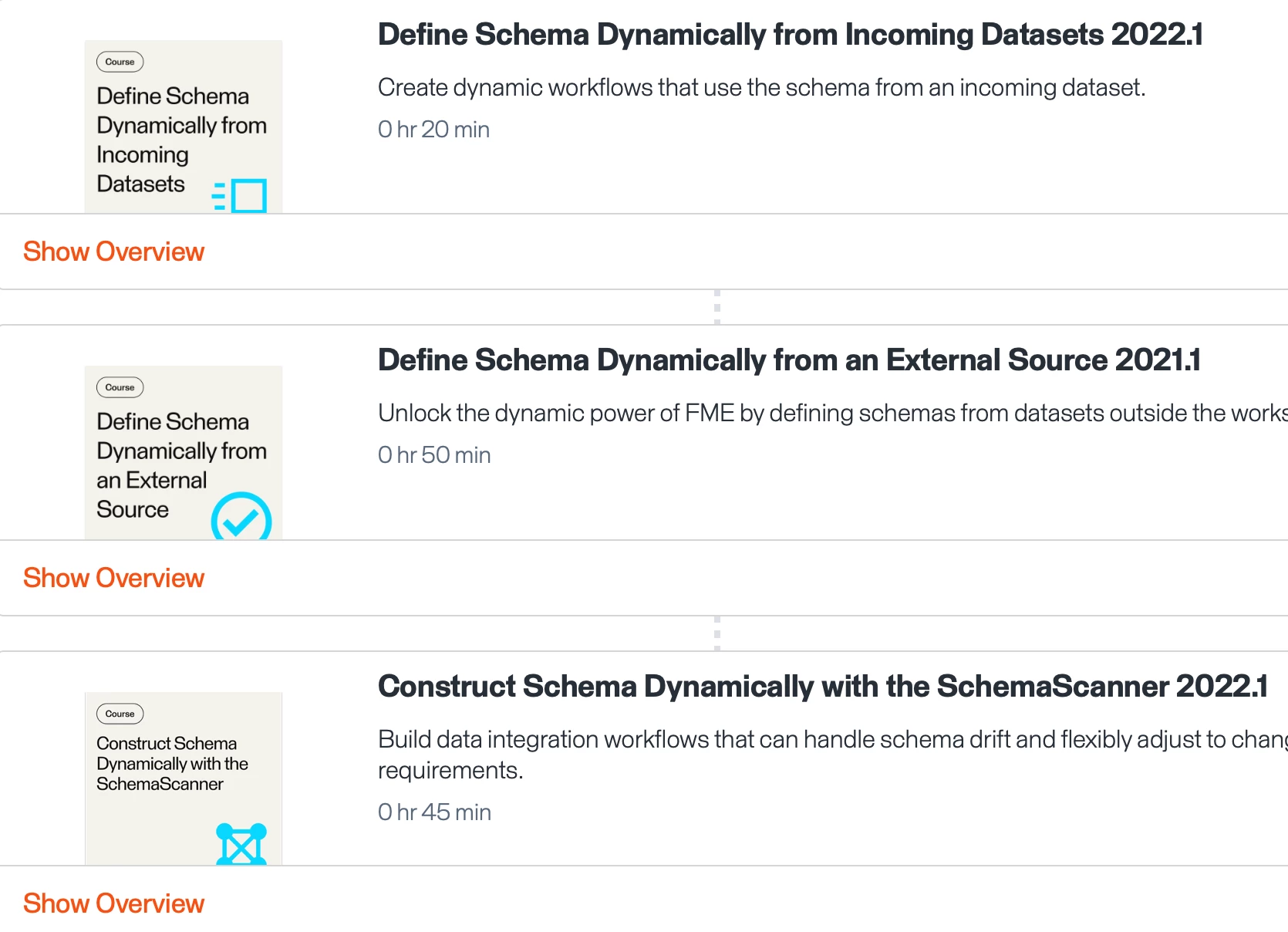

Academy https://academy.safe.com/path/advanced-reading-and-writing and consult the following units
SchemaScanner transformer with the schema and data ports going into a dynamic writer configuration
