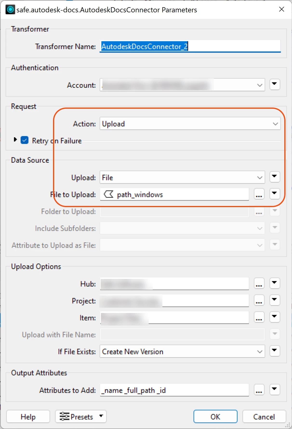

I’ve tried reproducing your issue by reading multiple files in from a folder using the Directory and Path reader.  In my case, I’ve filtered for just path_type = file to focus in on the problem with uploading files like so:
I noticed that you have an AttributeCreator.  Are you feeding the attribute you’ve set in the AttributeCreator in the AutodeskDocsConnector? For reference, these are my AutodeskDocsConnector settings:
If you are trying to upload both folders and files, you’ll have to use two AutodeskDocsConnectors--one with the Upload parameter set to File and the other set to Folder.
