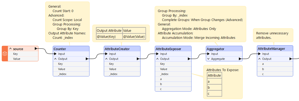

Hello,
I need your help. I'm looking for a workflow to transform my keys and values into a list. Here is an example:
I have this table:
Key Value
a 1
b 2
c 3
a 4
b 5
c 6
a 7
b 8
c 9
and I wanna transform it to
a b c
1 2 3
4 5 6
7 8 9
Thank you
Best answer by danilo_fme
Hi ​@hnahoulder ,
A possible way is shown as the screenshot below. See also the attached workspace example.
Awesome ​@takashi
takashi
  • Apr 17, 2025 9:29 AM UTC
Hi ​@hnahoulder ,
danilo_fme
Forum|alt.badge.img+58
  • Apr 17, 2025 12:27 PM UTC
Hi ​@hnahoulder ,
Awesome ​@takashi
hnahoulder
Forum|alt.badge.img+2
  • Apr 18, 2025 7:30 AM UTC
Thank you for your help guys, it works perfectly
