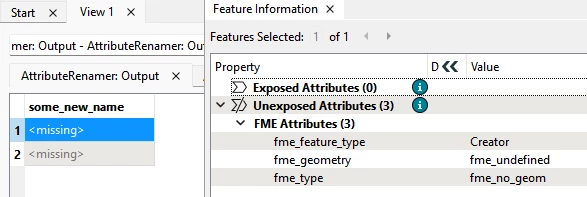

When ‘Remove Output Attribute’ is selected for ‘If Input Attribute is Missing’  The missing attributes (the attributes with no data) are still present in the output.  Any clues?

Ahh - the option is there to decide how to treat data which already has an attribute with the output name.
For example if I’m reading 2 shapefiles, one with an attribute called “Roads” and the other with “ROADS”. I want them all to be “Roads” so I put in an AttributeRenamer to rename “ROADS” to “Roads”. The option to “Remove Output Attribute” “If Input Attribute is Missing” is referring to the case where the input shapefile with the “Roads” has no “ROADS” attribute in  input.
Essentially this setting will either preserve existing values for “Roads” OR can map “Roads” to missing.
Anywhere you see a <missing> value in the data inspector table this just because you can have features with a mixture of different schemas but FME needs to have a way of showing it all in a single table. If you look in the FeatueInformation window there data aren’t actually there.
