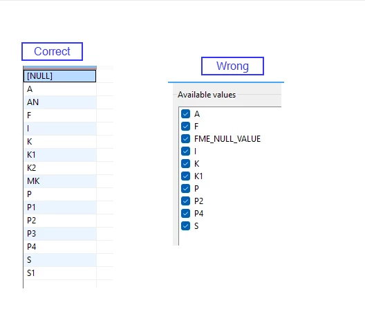

I want to filter all unique values of an attribute with the attributeFilter.
Iam importing the values stright from the data source using the import Wizzard but it is failing to list all availabel values. It really caught me of guard.
I checked the database for unique values marked “Correct” in the image vs the wrong output by AttributeFilter.
I used DuplicateFilter to aslo check for unique values and it returned the same as my SQL Query.
Am i using AttributeFilter wrong or is it not trustworthy?

Oh yeah maybe it is not checking all values. I have about 200 000 records in the database which is pretty standard in my type of work.
I tried again but instead of reading the values import from a dataset i used import from feature cache where I had all the 199 856 objekts cached, but the result was the same. So maybe there is a limit to how many objects it is reading from the cache too.
