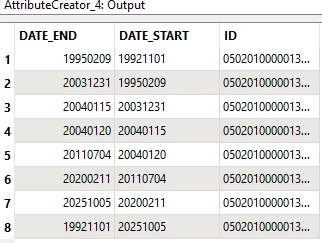

I have the following table, very simple:
DATE_START ID
19921101 0502010000013950
19950209 0502010000013950
20031231 0502010000013950
20040115 0502010000013950
20040120 0502010000013950
20110704 0502010000013950
20200211 0502010000013950
20251005
0502010000013950
I want to make te following result:
DATE_START DATE_END ID
19921101 19950209 0502010000013950
19950209 20031231 0502010000013950
20031231 20040115 0502010000013950
20040115 20040120 0502010000013950
20040120 20110704 0502010000013950
20110704 20200211 0502010000013950
20200211 20251005 0502010000013950
20251005 null 0502010000013950
Date_end is next value of date_start to create a cycles like this. This what i did:
I get to following result:
U see the problem is with the last date_end, he is using for that feature the first date_start. I dont now how.
Anyone a solution?

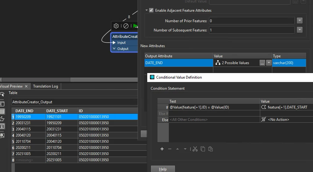

Best answer by ebygomm
7 replies
  • Nov 14, 2025 9:48 AM UTC
You should be able to use a conditional formula, so only set the date if the id matches the adjacent feature
kevink
Forum|alt.badge.img+3
  • Nov 14, 2025 9:54 AM UTC
How do you mean, what do i fill in the conditional formula?
  • Nov 14, 2025 10:11 AM UTC
kevink
  • Nov 14, 2025 10:27 AM UTC
THANKS!
