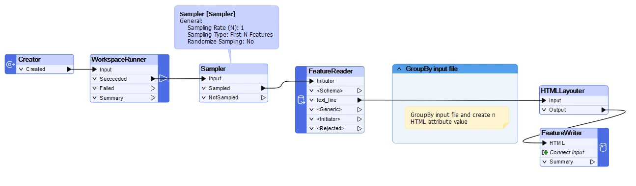

Just a quick idea:
You could write HTML reports as you did to a certain location. After all WorkspaceRunner ran (put a Sampler or DuplicateFilter after it), you could then use a Text File Reader pointed to that certain location and read in all the reports. Group the text lines by input file, send them to an HTMLLyouter and write the output as an HTML file.
