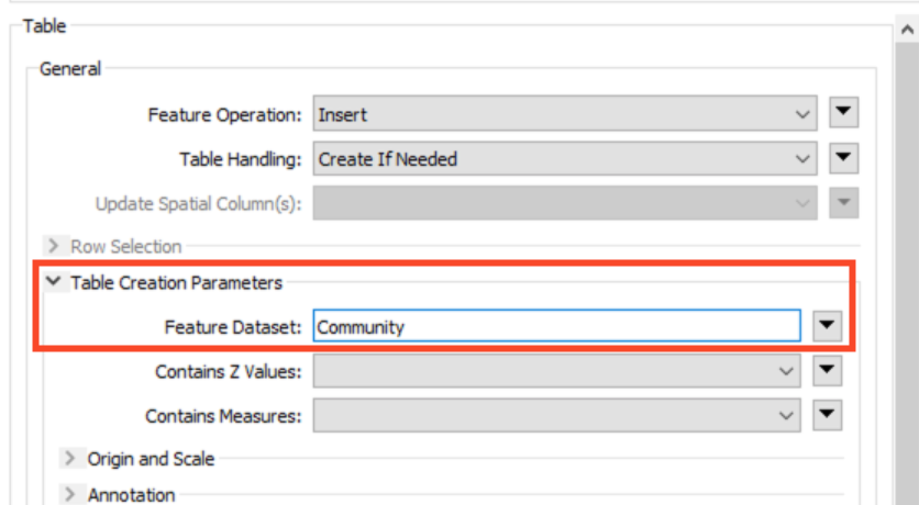

Did you add a Feature Dataset in the writer? It should be optional but I wonder if that will push things into the gdb.

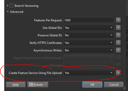

I am glad to hear. I wonder why that is though. I have found that “sometimes” we have to Click “Yes” to “Create FS using File Upload”. Sometimes not….Am I reading your solution correctly?
