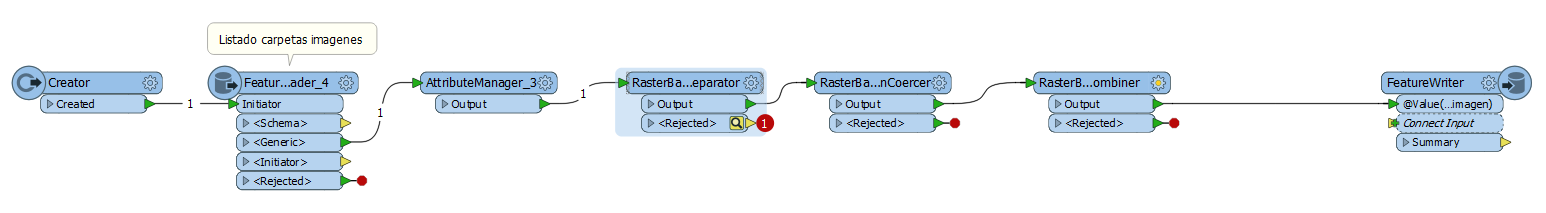

Hello! I´m new using FME. I have a question about RasterBandSeparator. I have used this transformer in a FME process and it appears the next error:
RasterBandSeparator_<Rejected>(TeeFactory): RasterBandSeparator_<Rejected>: Termination Message: 'RasterBandSeparator output a <Rejected> feature. To continue translation when features are rejected, change 'Workspace Parameters' > Translation > 'Rejected Feature Handling' to 'Continue Translation''
A fatal error has occurred. Check the logfile above for details
Best answer by ebygomm
It looks like you're using the featurereader to read a list of filepaths of images, not the images themselves. You need to read the raster images into FME before processing them with any of the raster transformers.
  • Apr 4, 2019 6:29 AM UTC
Ok, thanks @egomm! I have changed that and the process runs perfectly.
