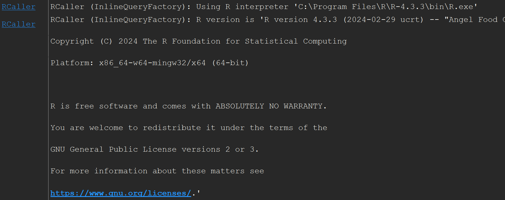

I am trying to use RCaller in FME 2024.1.3.0 with R version 4.3.3.
To get started, I followed the tutorials, but in every case, the script gets stuck at RCaller. There are no errors or warnings—it simply does nothing and keeps running indefinitely.
The last thing I see is:
It seems that the connection to R.exe is working.
Does anyone know what beginner mistake I might be making?

first thought would be to examine the transaction log where the Rcaller is, see if there are WARN or ERROR messages. Also try running the workspace with debug mode https://support.safe.com/hc/en-us/articles/25407543387533-FME-Flow-Debugging-Toolbox-Logging-Tools

I tried your advice with the transaction log and the debug mode. In this case, there don't appear to be any errors, only this warning:
But this can't be the problem. It still stays stuck at the same point, and the computing power cannot be the issue for this small task.
Do you have any further suggestions?
