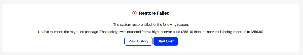

I just had to downgrade a local testing FME Flow (from 2025.2 to 2025.1.2) to solve some unforeseen breaking changes in 2025.2 (or probably in 2025.1.3).
But now I cannot install a backups from 2025.2 into the 2025.1.2 Flow:
I’m very sure that the backups does not contain anything that’s not workable in 2025.1.2, so it’s just a matter of administratively blocking the restore.
Why is this versioning stonewalling necessary at all ?
Why not just warn about potential problems and restore what can be restored ?

Hi Lars,
I'm really sorry to hear that you've run into these version issues. Let's start with some answers to your questions before we explore potential remedies.
Re: Version guardrails and backups - One of the main obstacles to restoring backups into older Flow versions is that upgrades and improvements between versions often require updates to Flow’s internal data model. This can include database schema changes, defaults, derived values, and how missing information is interpreted. As an example of how this can complicate backwards compatibility, let's look at two hypothetical connection schemas:
Let's say that in the older (hypothetical) version of Flow, connection credentials were stored directly within the connection table:
connections (
  id,
  username,
  password_plaintext
However, in the newer (hypothetical) version, security has been improved by normalizing credential storage, and secrets are now moved to a dedicated, encrypted credentials store:
connections (
  id,
  username,
  credential_id
credentials (
  id,
  secret_encrypted,
  encryption_version
Once this update has been applied, the original plaintext password no longer exists, and the older Flow version has no reliable way to reconstruct the data.
Of course, there are many variations on this example, but the core dilemma at play is the same: once changes like this are applied and a backup is created, restoring that backup into an older version would require Flow to recreate data that doesn't exist in the current version.
Re: Why not restore with warnings about potential problems - This stems from the backwards-compatibility dilemma outlined above. Some changes cannot be undone but are easily detectable (as in the previous example of credential normalization); there are also some changes that cannot be reliably detected.
For example: Let's say that an older version accepted NULL values for timezone (defaulting to server local time), but the newer version no longer accepts NULL values for timezone and instead defaults missing values to UTC. In a downgrade scenario, the older version would have no way to know whether a timezone  value of UTC was explicitly set by the user or filled in during the upgrade.
That's a very limited example but hopefully it helps illustrate the crux of this issue. Allowing a backwards restore operation with warnings would create a situation where the older version is handed data structures and logic that it was never designed to interpret. Even if the restore appears to be successful, the resulting behavior could be unpredictable and difficult to diagnose. Due to these risks - and the potential for catastrophic situations - FME Flow does not support restoring backups into older versions.
Finally, if you are looking for ways to migrate content from 2025.1 to 2025.1.2: While full configuration backups can’t be restored to older versions, Projects are useful in situations like this since they can export (and re-import) content such as repositories, workspaces, and related resources in a more version-tolerant way. Projects don’t capture the system state as comprehensively as backups (which include users, schedules, credentials, etc.), but if you need to rescue any core content from 2025.2 it might be a partial solution.
