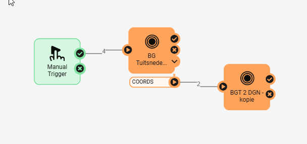

  • I have a manual trigger that includes a manual parameter called "Geometry" (GEOM).
  • This GEOM parameter is then used in the subsequent Workspace.

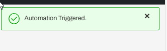

Similar to the Workspace app, I want to show a "Running..." button while the script is running, and once it finishes, makes a download URL available to the user. However, the only feedback to the user is the green "Automation Triggered." message.
There’s no further feedback for the user, that the script is running and the download URL is not shown—even though I made the Data Download available in the “Service” during publishing.
