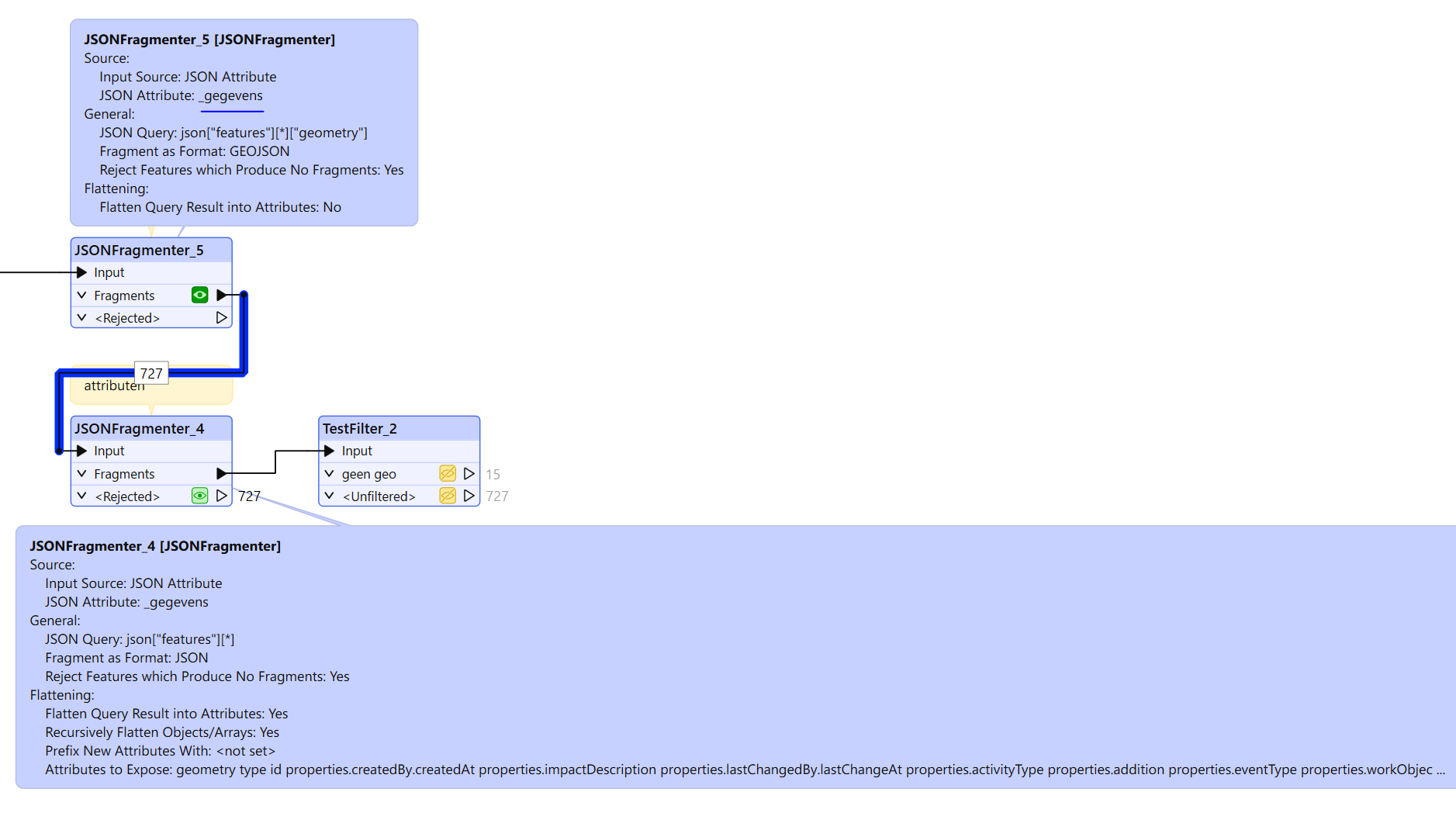

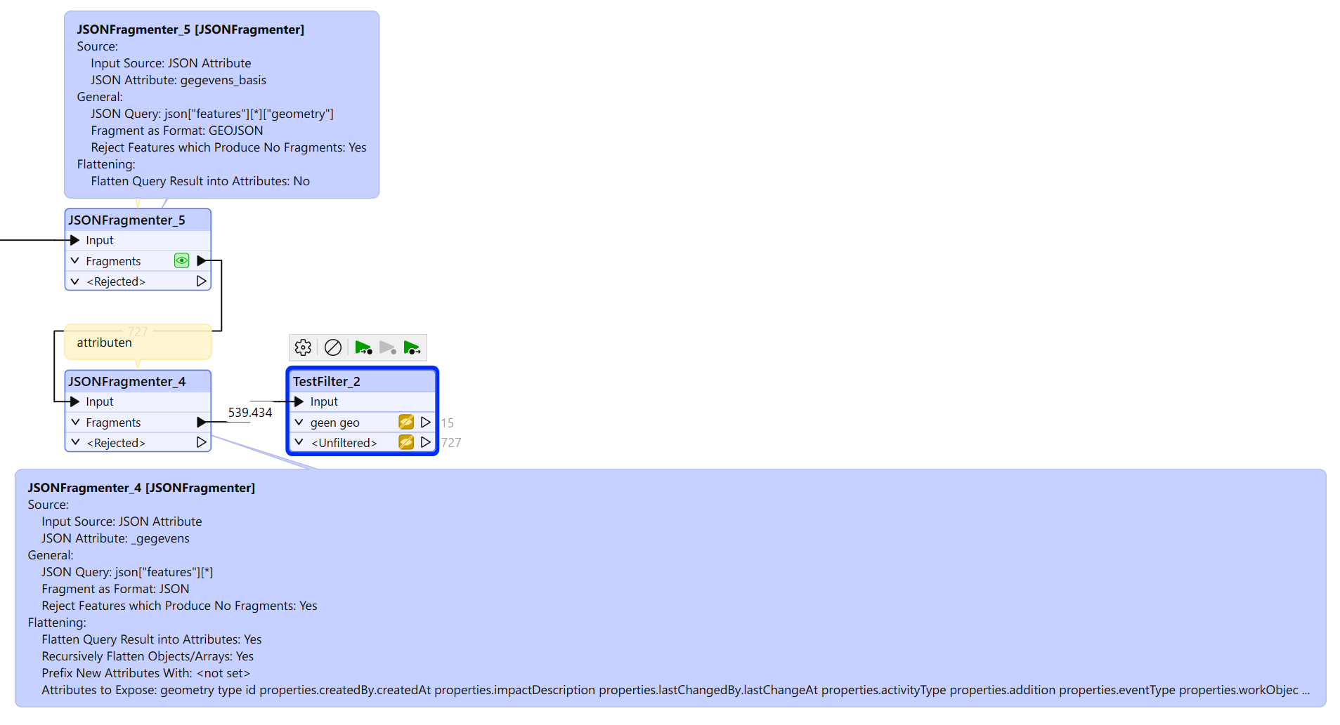

  1. Current setup below. First I extract the geometry from the attribute (gegevens) and then from the same attribute (as the resulting attribute gets changed, thus I created another with the same information named gegevens_basis) by the fragmenter for the attributes. However it multiplies the number of attributes (700+ to 500,000+).
  2. Another setup (also below) sent all geometry to rejected.

Tried a different setup using the same attribute, but it sends the attributes to rejected:

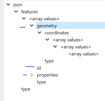

Structure:

The structure seems to comply with GeoJSON format. Have you tried saving the response into a file and reading it with GeoJSON reader?

I just found out that shifting attributes to the first JSONfragmenter and then using the resulting 'gegevens’-field as imput for a geometryreplacer (using GeoJSON for geometry encoding) did the trick.
Below the setup (after the httpcaller).
