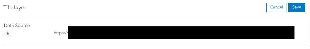

Hi,
Does anyone know how to retrieve the information from the Settings tab of a layer published to Esri ArcGIS Online (AGOL)? I’m specifically trying to get the Data Source URL.

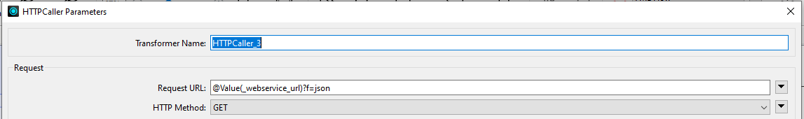

The Request URL I’m using doesn’t return that information. Any ideas?

I think you should not use the service url but the item to find this.
For example:
https://www.arcgis.com/sharing/rest/content/items/c1a3bf98b1d148a6917ad85662d82704?f=pjson
This will return a json with “sourceUrl”.
Also see https://developers.arcgis.com/rest/users-groups-and-items/item/
