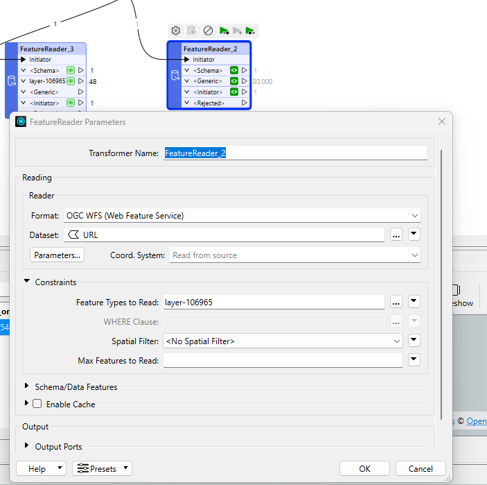

Hi,
I’m trying to use the OGC WFS FeatureReader to read in features based on a dynamic URL stored as an attribute. This is because in the URL link, I want to have a bounding box parameter that changes based on the extent of another dataset. I.e., I only want to read in the features that are within the bounding box of another dataset.
I’ve set up an attribute “URL” that contains the bounding box parameter.
When I hard-code in the URL with the bounding box parameter into the FeatureReader, it works as expected and reads in only the features within the bounding box.
If I replace the URL with the dynamic “URL” attribute, it ignores the bbox parameter and reads in everything. I
And yes, I’ve confirmed that the dynamic URL attribute is exactly the same as what I’ve hard-coded into the FeatureReader that works. Does anyone have any idea how I can fix this? Or any other ways I can read OGC WFS features with a dynamic bounding box?
I’ve tried the Spatial Filter parameter in the FeatureReader too and I can’t get it working. Would prefer dynamic URL requests in case I want to add more parameters though.
UPDATE:
I haven’t changed anything between the two FeatureReaders but now I can’t get either of them to filter by the bounding box parameter. On the other hand, hard-coding the URL into a normal Reader works perfectly every time.
Best answer by oliver

scottpool
Forum|alt.badge.img+2
  • February 27, 2025
Thanks both ​@nielsgerrits and ​@oliver for the help!
I tried the first approach of using the Spatial Filter with the bounding box geometry again. For some reason I just can’t get it to work, I’m not sure why
What did work was the third approach suggested by ​@oliver - works perfectly now in the FeatureReader so thanks for those tips. However, I will take a look into the XML filtering options as well when I’ve got some more time on my hands

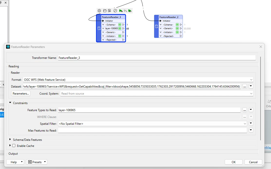

Hi ​@scottpool!
This has left me no peace. 😎
So I got an account and an API-key from LINZ and tried it out.
First conspicuous feature:
5458856.7335033035,1762303.2917200956,5460668.162203304,1764145.6364200956
It seems to me that your coordinates shown above (in your screenshot) have the wrong range sequence (YMIN,XMIN,YMAX,XMAX), if they are in EPSG:2193?
When I display it, the BBOX looks like this:
Wrong order of coords?
If I reverse the order of the coordinates, I get this BBOX.
X and Y swapped
Maybe the BBOX you wanted?
I assume this was your intention?
If this is the case, then [Bounding Boxes OGC-Intersect] also works as expected in FeatureReader.
I get 48 tiles.
Built-in BBOX filter
Result: 48 tiles
Kind regards from Germany to New Zealand
Oliver
