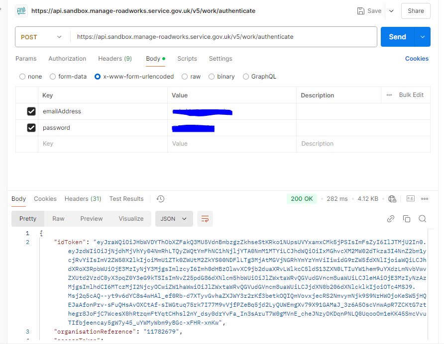

I have successfully POST Authenticate using postman. But have no luck using HTTPCaller? Any idea please?
Best answer by nielsgerrits
Ah sorry, because this is a POST, you need to move the parameters from the headers to the body.
In Upload Body you need
emailAdress=<emailadress>&password=<password>

What is the error, issue?
Can you printscreen the HTTPCaller’s screen?

nielsgerrits
VIP
Content Type is set to text. Please try and switch that to
URL Encoded (application/x-www-form-urlencoded)
elmido13
Forum|alt.badge.img+3
  • November 22, 2024
@nielsgerrits Thank you for your response.
Still getting this error below
{"message":"","error":{"fields":{"body.emailAddress":{"message":"'emailAddress' is required"},"body.password":{"message":"'password' is required"}},"status":400,"name":"ValidateError","x-request-id":"kcgXSuAoin2FBs4hVrioNOfk48s5crl0s6IIb-SDMZjCsKZXWhBawg=="}}
nielsgerrits
VIP
  • November 22, 2024
elmido13
  • November 22, 2024
@nielsgerrits  Works Perfectly. Thank you for your help
