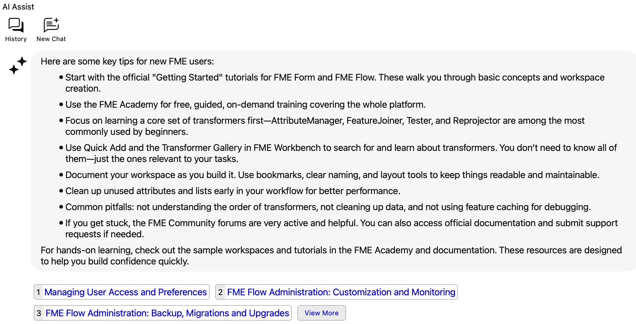

j.botterill
Forum|alt.badge.img+69
  • Aug 1, 2025 6:06 AM UTC
AI Assist tells us:
