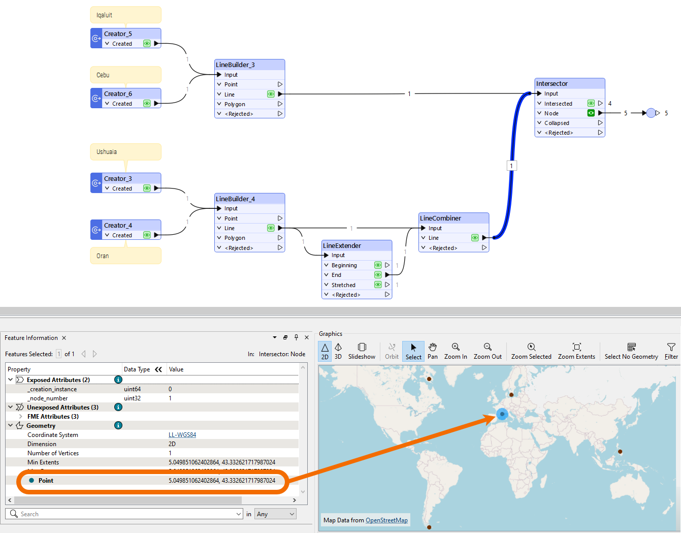

Let's put that information together to identify the treasure's location:
There are some important notes about the process to take into account:
So, the actual numbers you should have gotten - if you completed every puzzle - are as follows:
| Puzzle Set | Location | Latitude | Longitude |
| Codes | Congreso Nacional, Ushuaia, Argentina, South America | -54.8259124 | -68.33802447 |
| FME | Boulevard Freres Guarrab, Oran, Algeria, Africa | 35.70389182 | -0.65374145 |
| Images | University of San Carlos, Cebu City, Philippines, Asia | 10.351732 | 123.912741 |
| Geography | Sinaa St, Iqaluit, Canada, North America | 63.744843 | -68.515648 |

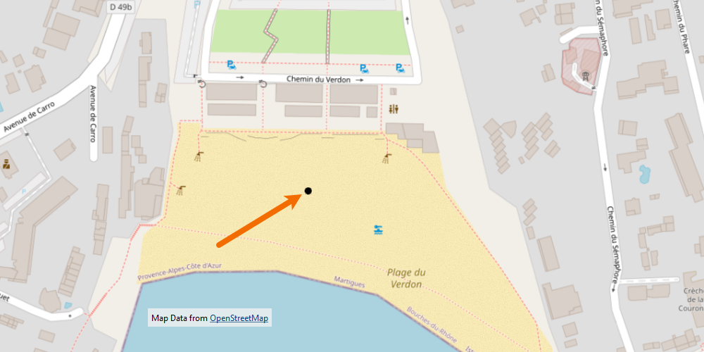

| Intersection | Plage du Verdon, Martigues, France, Europe | 43.33262172 | 5.04985106 |
The codes and FME clues would be exact, because they were provided as actual coordinates. The Images and Geography clues might be slightly different, because you had to estimate them from a photograph or map.
Here's the FME workspace I created to find the intersection point. I threw in a LineCombiner just to visualize the line extension a little better.
And here's a map of the intersection point where the treasure was buried:
