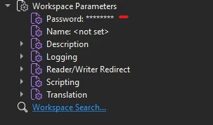

  • Nov 7, 2025 11:02 AM UTC
If you are referring to methods used in the workspace or PythonCallers, you can set a password in the Workspace Parameters. Other users can still run the workspace in Quick Translator without the password.
  • Nov 7, 2025 11:05 AM UTC
A password in a parameter is not really secure as anyone with access to the workspace can read it in plain text with a parameter fetcher
dustin
Forum|alt.badge.img+36
  • Nov 7, 2025 11:08 AM UTC

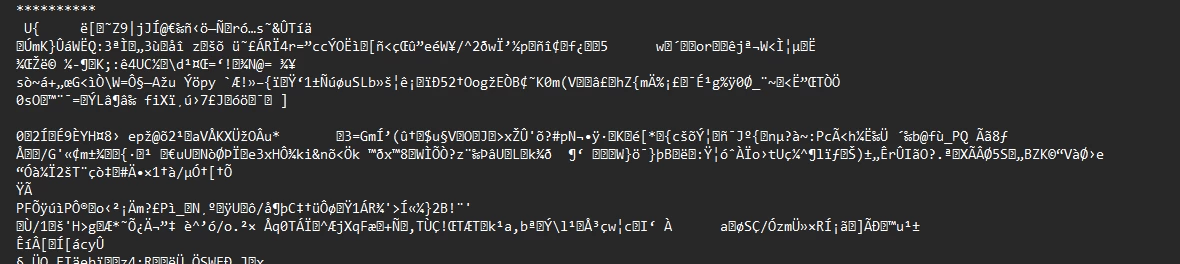

Can they? This is a password protected workspace in notepad. If there is a way around for this, I don’t see the point in the password parameter.
  • Nov 7, 2025 11:10 AM UTC
Sorry, i misread that you were referring to a workspace password. I’ve encountered many people who think that because a password in a user parameter shows as ***** it is secure.
