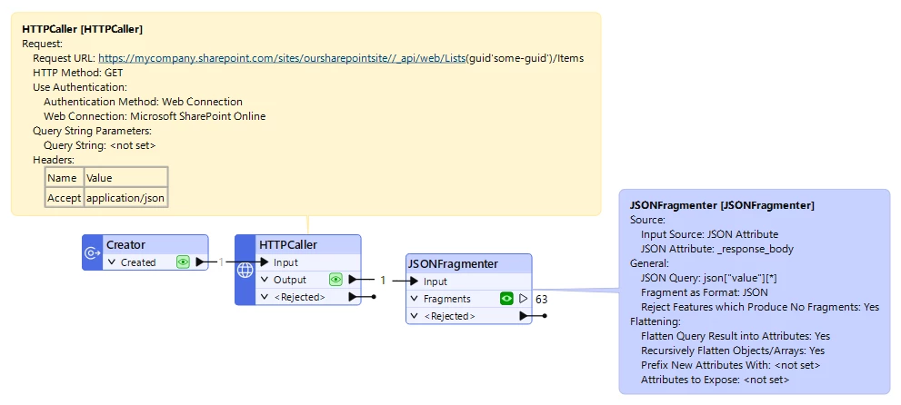

Since the URL used by the SharePoint readers include all the list’s attributes twice, more or less, we could ask the list admins to remove some attributes or shorten their names I guess.
But instead I ended up using the URL posted by FME in the error log, but without any of the query parameters.
Something like this;
https://mycompany.sharepoint.com/sites/oursharepointsite//_api/web/Lists(guid'some-guid')/Items?%24select=Title%2Clotsofattributes...%2C...etc&%24expand=ContentType%2CAuthor%2Fid%2CEditor%2Fid%2Clotsofattributes...%2C...etc&%24top=5000
is shortened to this;
https://mycompany.sharepoint.com/sites/oursharepointsite//_api/web/Lists(guid'some-guid')/Items?%24top=5000
Then I just used HTTPCaller with an “Accept: application/json” header and exploded the response with JSONFragmenter:
EDIT: Added the excellent addition by ​@ecx to fetch up to 5000 items. See their answer for also resolving nested attributes:
Wow, good stuff!
A very simple and obvious in hindsight way to resolve this!
Funnily enough my ETL process which I set up with SSIS failed today, tomorrow I’ll give this a go and likely replace it with this.
Thanks for posting your method to fix it!

I’d like to also add that the best answer by default will only return 100 items, you can add
items?$top=5000 to the end of the HTTPCaller url to get up to 5k items in one request.
If you have nested data (for example a person object in your sharepoint list) you will also need to alter query to extract this info by using:
items?$top=5000&$select=*,PersonObject1/Id,PersonObject1/Title&$expand=PersonObject1
Also by obtaining the list via this method the names are not resolved, unfortunately. But at least it works!
