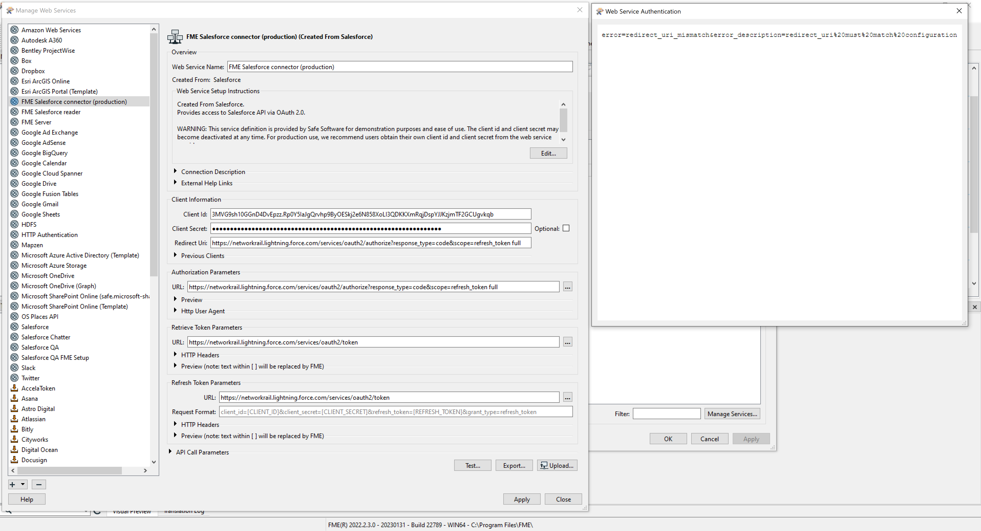

I am trying to configure a web service to use the Salesforce Connector.  When trying to test the connection, I keep getting error:
error=redirect_uri_mismatch&error_description=redirect_uri%20must%20match%20configuration
I believe this relates to the callback URI syntax, but I don’t know what it should be.. any ideas?

Hello @alsherren, thanks for posting to the FME Community! Can you try setting the Callback URL (in Salesforce) and the Redirect URI (in FME Form) to : https://localhost
Please update me on whether this resolves the error. Happy to help, Kailin.

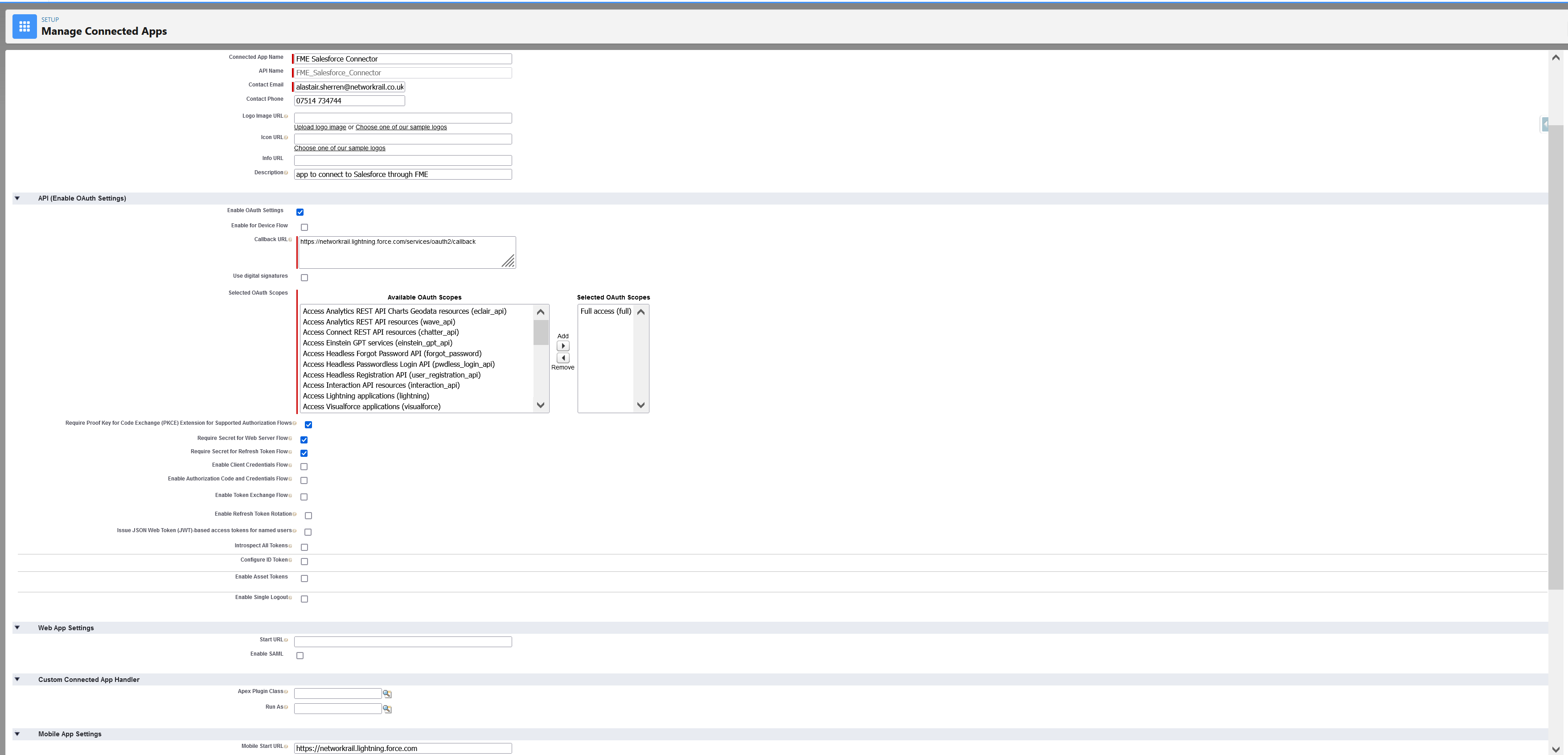

HI @kailinatsafe Where should this be done?  I can confirm the callback URL has been set in the app manager settings:
kailinatsafe
Forum|alt.badge.img+24
Hello @alsherren, awesome - that looks correct on the salesforce side. Within FME Form, we can set https://localhost as the Redirect URI in the following location:
Let me know if this works or if we are still unable to connect. Best, Kailin.

Hi @kailinatsafe I can confirm URI has been set to the same in the Salesforce (Read Only) web service, and still produces same error as previously.
