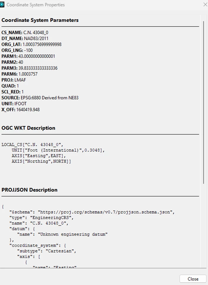

I’m using FME 2024.2 to read ORD DGN files stored in ProjectWise.
The DGN files have a local coordinate system (LCC) defined in ORD, but when I read them into FME, the detected GCS appears incorrect — particularly the ORG_LAT value. Because of that, when I try to set the coordinate system and reproject to State Plane, the transformation doesn’t work properly.

GCS shown for features in FME

Hi ​@chelseawu,
I’m sorry, but this is a known problem in FME 2024. We have fixed it for FME 2025.0 and newer, which can be obtained from safe.com/download.
