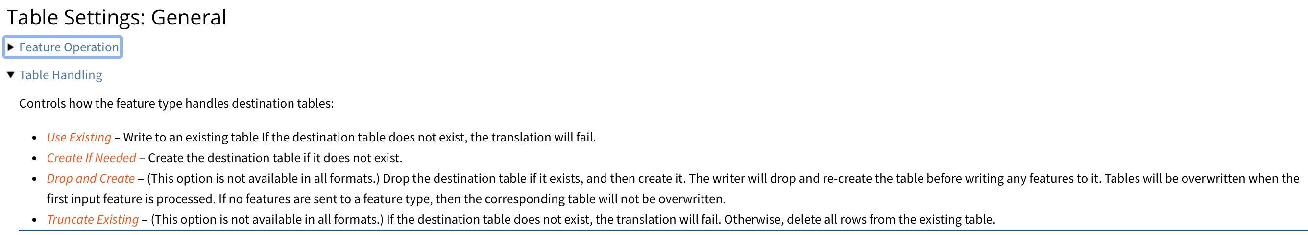

Are you using a Writer or a Feature Writer with the Oracle format. The advantage of the workflow transformer Feature Writer is that there is a Summary port which will output the total_features_written
A screen shot of the Writer feature type parameters is always helpful. Is the Feature operation = INSERT and what about the “table handling”. https://docs.safe.com/fme/html/FME-Form-Documentation/FME-ReadersWriters/oracle_nonspatial/feature-types-w.htm
You may want to double check that the username in the Oracle (database connection / easy connect string) has indeed the permissions to commit edits

I am using an Oracle writer. I am using fme_db_operation as the Feature operation so it can handle INSERT, UPDATE, and DELETES, and I am using ‘Use Existing’. I guess I didn’t fully explain in the original post but the main issue is that the writer will work fine for months and then all of the sudden I get a bug from the client saying this table isn’t being updated any longer, when I do my testing I find that if I just replace the Oracle writer it will start working again. So it seems like it goes “stale” or something.
