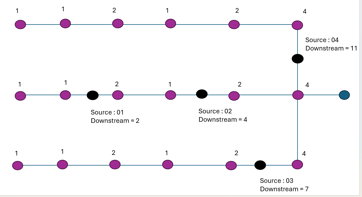

How to trace downstream in the network with multiple sources and accumulate the value from the intersected nodes of each trace? To Illustrate please see below. Black circles are the starting points.
Appreciate your help.

Hi ​@elmido13 ,
I think you can use NetworkCostCalculator to achieve the goal in this case. The process would be a bit long story, see the attached workspace example to learn more.

Hi ​@elmido13

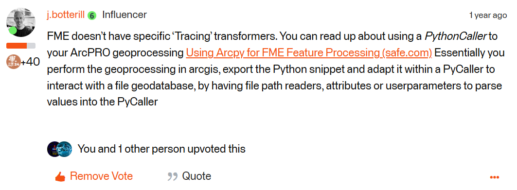

In my mind I would want to say there must be some way to set this up. For each point dissolve all lines downstream of the point, then use that dissolved line to select all points along and then do the calculation. Buuuut, for actual tracing tools I think ​@j.botterill covered it with his answer a little while ago.
takashi
  • June 7, 2025
Hi ​@elmido13 ,
elmido13
Forum|alt.badge.img+3
  • June 12, 2025
@takashi Thank you for your assistance. I truly appreciate it. I will review the WB and learn from it. I’ll let you know whether this addresses the issue discussed here.
