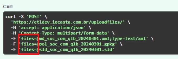

The header part of the request is documented here :

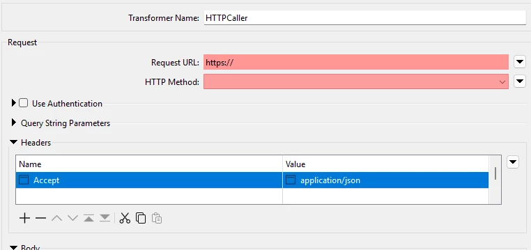

You don’t need to set the “content-type” one, it will be automatically defined with what you choose here :
But the “Accept” one might need to be defined, like this :

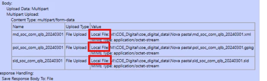

Another thing, the documentation asks for parts that should be called “files” :
But it seems like you called yours “Local File” :
That’s why you have the error that we could interpret as “missing the ‘body’ or ‘files’ key”
You should change that too
