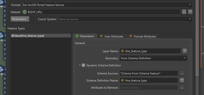

I am trying to do a similar thing but using a ‘FeatureWriter’ transformer part way through the workbench, so wanted to see if there is a way to create a parameter for the layer name, partly due to spaces being in the layer name. Is this possible?
In the below image, I want to replace fme_feature_type with a calculated name but up stream attributes do not seem to be available.
I am using Form 2023.2.1
