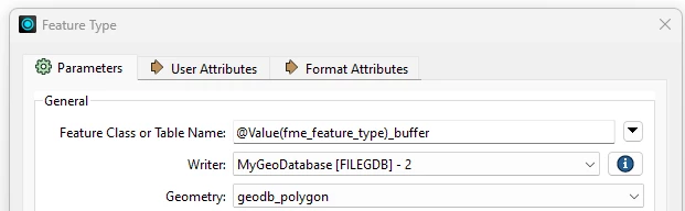

fme_feature_type is set when you use β€œSingle Merged Feature Type".
Set the value for β€œFeature Class or Table Name” toΒ @Value(fme_feature_type)_buffer

I tried this but I got the following error:Β Esri Geodatabase Writer: Feature Type Definition 'Rivers_buffer' was requested, but not defined.Β

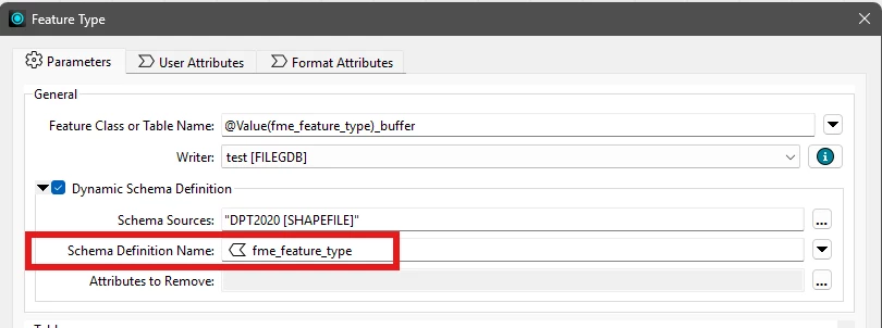

You certainly have not set the "Schema Definition Name" parameter:

Thanks so much. My problem is solvedΒ
