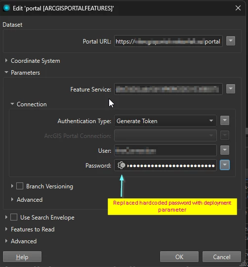

Hi ​@ali-safe, I believe I am experiencing a similar problem and wondered if there was any solution. If I replace the password on a ESRI ArcGIS Portal Feature Service reader or writer with my deployment parameter for the password it works for the duration of the time I have the workspace open.
Parameters ArcGIS Portal reader

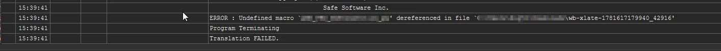

However, when closing the workspace I get the warning dialog about embedded passwords, despite having replaced the only password with a deployment parameter. Opening the workspace again and running gives the following error, which is resolved by reentering the password or setting it to the deployment parameter again.
