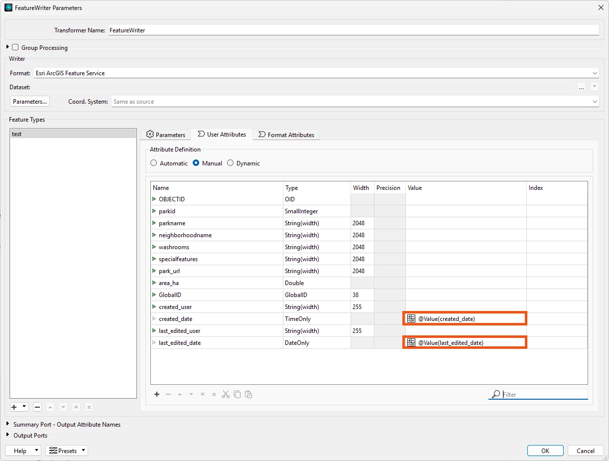

Hi folks,
I've submitted a ticket for this behavior (FMEENGINE-87880).
The current workaround for the ArcGIS Feature Service Writer to accept UNIX milliseconds (if Data type is String) is to set the Attribute Definition as Manual and specify the Attribute with the Date value in an arithmetic editor within the Writer's User Attributes.
I apologize for this inconvenience. Thank you for your understanding.

Hi everyone,
Esri ArcGIS Connector 3.13.2+ resolves the issue of writing UNIX Epoch Milliseconds to Feature Service, so an arithmetic editor is no longer required.
Our developers are working on an option for the Esri ArcGIS Feature Service format reader to read dates in FME datetime in addition to reading datetime values as-is from the data store (FMEENGINE-88767).
