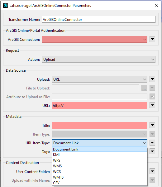

There’s a new Safe official “out of the box” solution for this question in the latest realease of the ESRI AGOL Connector Hub Transformer.
The Action Item: Upload has a Upload: URL value and a longer list of URL Item Type, including my Document Link. So if you’re looking at adding the URL of an AGOL item into Enterprise this is the best approach using FME 2025.0.x.
Note added later: While a URL can be uploaded and a portal item (AGOL or Enterprise) created from this URL, the item is not fully supported across other apps like Hub or Sites. It is functional. Please see the long list of supported types for URL document link listed on ESRI’s document.
