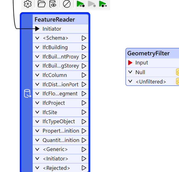

Just another question. When I add a FeatureReader, where should I connect it to the Geometryfilter? Should it be on the Schema or should I connect all of them?:

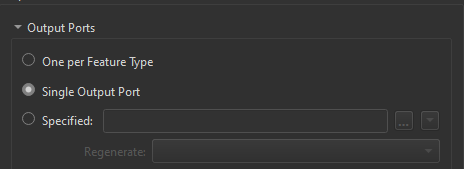

Hi I put my output ports on:
in your case you can just connect 1 port to the geometryfilter.
