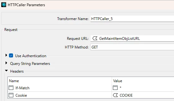

Aha, we had a ein this morning, my Dev workout that we needed to save the cookies to keep the session open and the token valid. It appears the odata service use a combination of the cookies and the token to authenticate.

We found that if you store the set-cookie value from the token response as an attribute, you can use that as the Cookie header of the main request. This eliminates the need to save the cookies.
