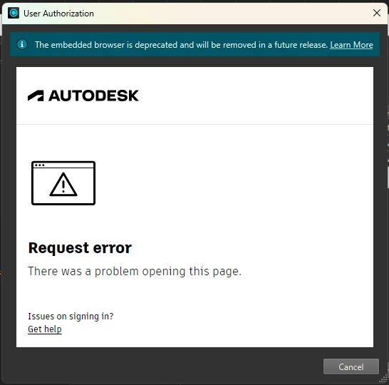

As of today we get a message trying to login to Autodesk with the FME web connector.

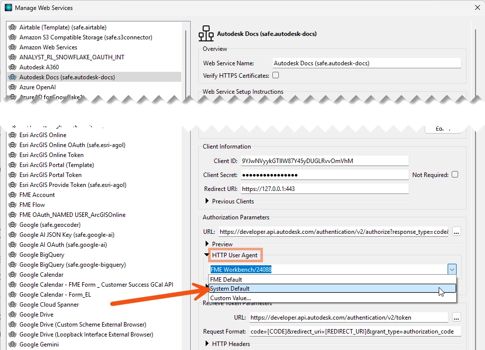

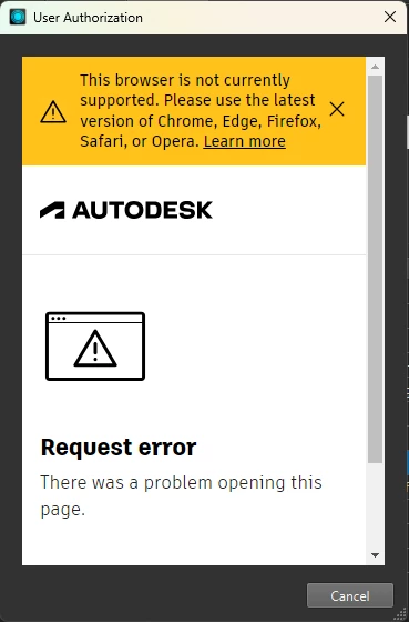

From the details you shared so far, it looks a lot like an issue we’ve noticed with the Autodesk API restricting FME’s embedded browser, but just to confirm, what specific build of FME are you using?
If that’s the case, a quick and long term fix would be to use the external browser, available in FME 2025.2+ which is already available on the downloads page! (Proxy Redirect worked well from my testing)
There’s currently a workaround for the embedded browser with FME 2025.1.3.1+ where changing the User Agent (within the Manage Web Services dialog) to System Default will also bypass this error.

The notification in 2025.1.3 changed but the error persists.

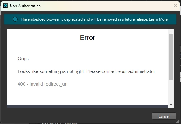

In 2025.2 the error changed from none descriptive to pretty clear:
When switching to the “Proxy Redirect” setting it worked, thanks. But this is not available within 2025.1.3 or older versions. We cannot change to 2025.2 instant so how could we solve it for older versions?

The fix for FME 2025.1.3 and earlier would be to change the redirect uri to https://fmeauth.safe.com/v1/oauth2
While it it possible to have multiple redirect_uri’s per App. Safe Software probably removed the old one and replaced with the new one.
But the Autodesk Packages is still installed with the default old redirect uri as far as I can test (removing and reinstalling)

The redirect issue you noted is now solved in FME 2025.1.3.2 - Build 25645+!
  • You should be able to authenticate using that and newer builds using User Agent= System Default or External Browser Authentication

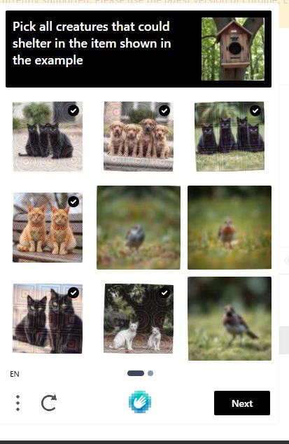

By the way “User Agent= System Default or External Browser Authentication” also fixed the annoying triple “are you a robot?” screens selecting dog houses hanging in trees.
