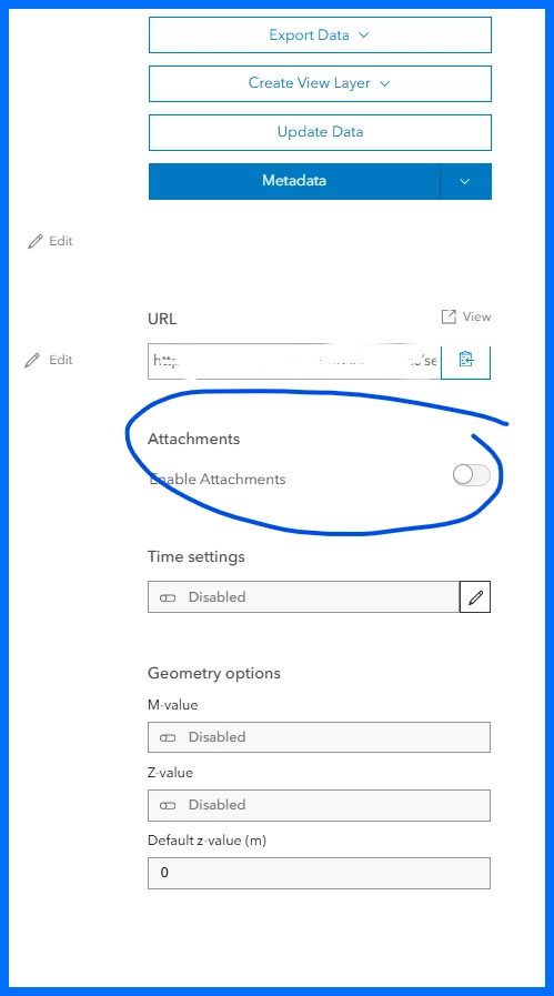

Hi ​@marta.podsiad First thing to set is to enable attachments on the layer.

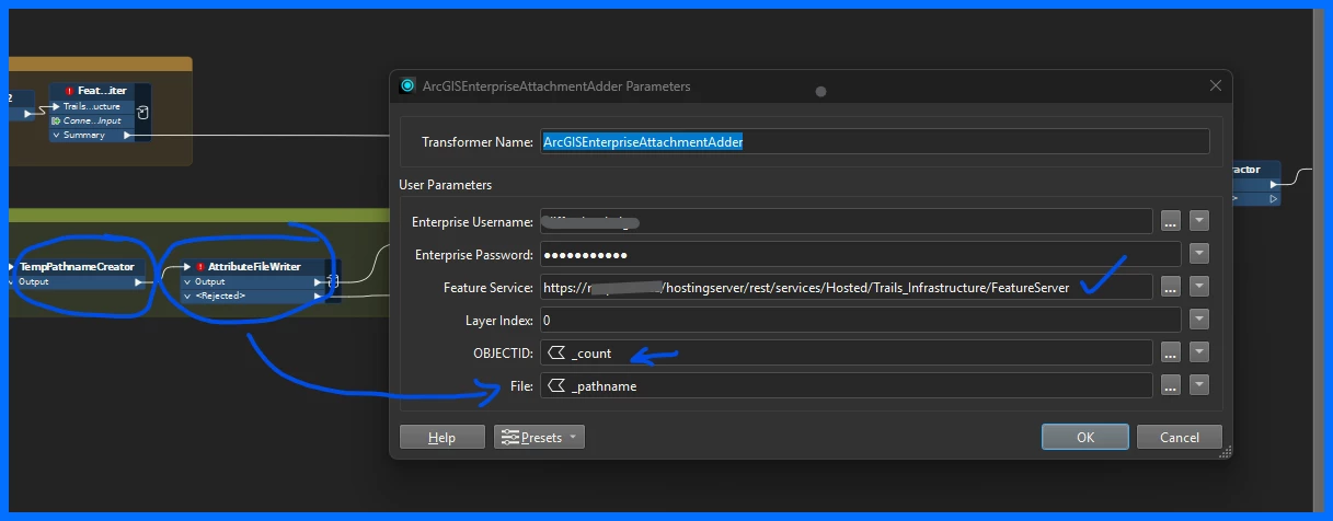

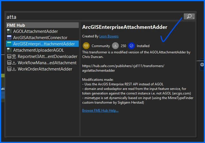

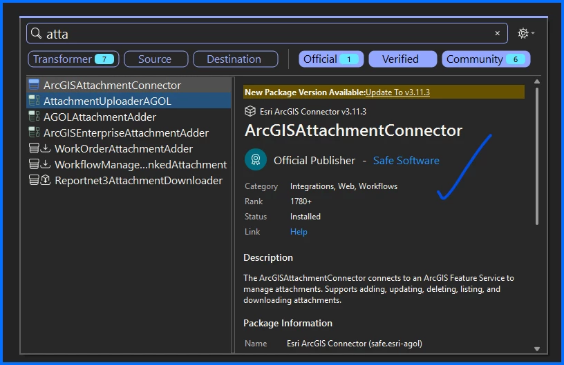

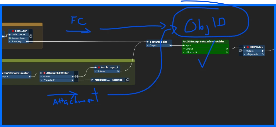

Gotcha! NP. That’s just the first step. I have done this a few times and forget to enable the “Enable Attachments” and then scratch my head as to why it isn’t working. For an existing FC there are a few transformers that handle it really well. Key is to have the Object ID from the feature you want to make the attachment.
Attachment Adders 2024:
Attachement Adders 2025:
if reading in a bunch of pics and they are rasters in the workbench it is important to use the temppathname and write out the file to a jpeg format and use that path to upload the file(below) If you have a list of files from a known location and they are jpeg i think you can skip this step and just use the file path (in flow). Hope this helps!
