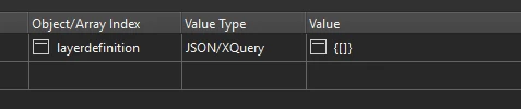

Have you tried this?

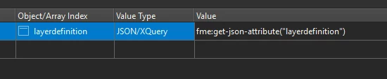

Another option is to put {} in an attribute then use that as the value
