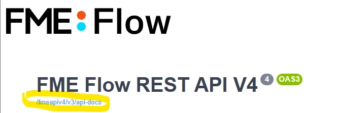

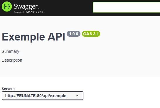

Hey ​@rylanatsafe,
I think he is talking about an equivalent ofΒ http://<fmeflowweburl>/fmeapiv4/v3/api-docsΒ but for Data Virtualization API.
As of FME 2025.1 b25606, FME Flow doesn’t generate any API documentation endpoint, or doesn’t show itΒ :
It would be good toΒ have something likeΒ http://<fmeflowweburl>/api/<apiname>/api-docs
