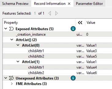

For more context on the issues with automatic conversion of FME entities to JSON, what should the JSON representation of this list be?
The FME data model combines the concepts of list and object

"_creation_insntace": 0,
"AttrList": [
"Value1",
"childAttr1": "Value3",
"childAttr2": "Value5"
"Value1",
"childAttr1": "Value4",
"childAttr2": "Value6"
This would be one option. Am I missing something there?

Well, then the indexes no longer match (and it's a pretty ugly - but conforming - JSON list)

Maybe it’s not really an issue, but a list with two elements becoming a list with four elements doesn’t seem proper to me.
And trying to convert it back to FME feature (with a JSONFlattener) would give AttrList{0-3} instead of AttrList{0-1}. So it might be a lossy process.
Agreed - But I don’t really see any other option for it - In the end there is actually not way to create this from json in FME so either skip out the values directly in the list (in the case there is an object) or throw an error. The user needs to makes sure their data is compatible I guess
