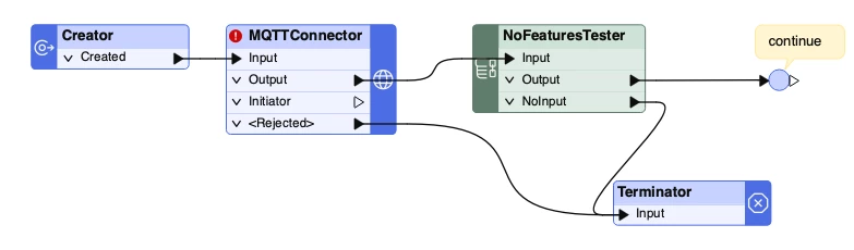

You could change this to an Automation using a Schedule every X minutes and a Run Workspace action
Also have you considered adding a NoFeatureTester transformer after the Connector transformer. Coming out of the “NoInput” port, something like
Rather than terminator, you can of course use an Emailer transformer and parse in the rejected error message or another message you use attribute creator to make coming out of the no input port
You may need to upload the custom transformer NoFeatureTester to Resources > Engine > Transformers in the Flow UI
 https://docs.safe.com/fme/html/FME-Flow/AdminGuide/Sharing_FME_Engine_Resources.htm
