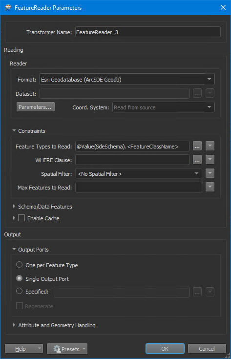

This is possible already, just replace the schema with an attribute:
@Value(SdeSchema).<FeatureClassName>
This will change the FeatureReader to be Generic, but with an AttributeFilter and AttributeExposers you’ll have the same result, using only one FeatureReader.

I think I tried that before I posted this idea. Not sure why it seemed it didn't work before or I got that impression, but after trying again and using the AttributeFilter I have untangled my spaghetti.
