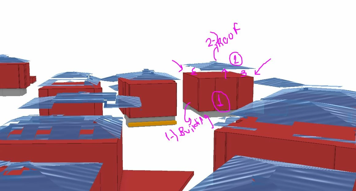

Hi, I want to overlap to my building and roof. I added one photo. 1(building) will go to 2 (roof). I know extruder transform. But also which transform can I added. Because it s not enough. This are .shp format.

Hi @bayram​ would you be able to share you source data, a sample of the source data, with us so that we can take a better look at the data and its issues? My first thought is that you could use an Offsetter to change the Z elevation of the roof and lower it to touch the building.
