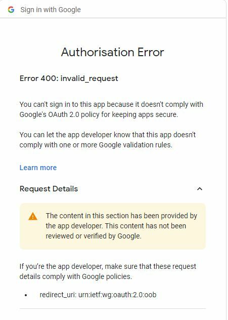

I have a workbench which has the GoogleDrive Connector in it which downloaded files to a local folder for me however it has stopped working and I get an Authorisation Error 400. When I go to authenticate my web service I get the attached message

and error message below. Not sure where to from here. It was working but I am a total novice at web connection stuff.
2023-06-01 15:11:03| 0.9| 0.0|WARN |Request to update access token failed. HTTP Error: HTTP/1.1 400 Bad Request
2023-06-01 15:11:03| 0.9| 0.0|ERROR |Python Exception <FMEWSException>: Type: 3, Number: 1, Message: Failed to get authorization header.

Hello @lferg​,
Google shutdown the use of the special redirect URI `urn:ietf:wg:oauth:2.0:oob` on October 3, 2022. This was the redirect URI used in Google-related web service templates in FME 2021 and older.
Safe updated the redirect URI (to https://localhost) for any affected web service templates for FME 2022 releases. However, older releases such as 2021 still uses the defunct redirect URI. Are you using an older version of FME and are you able to upgrade to FME 2022 and newer?

Thank you Debbiatsafe. I did wonder if it was a version issue. I'm running FME 2021.2.6 but will look at installing 2022

You're very welcome! I just want to add it is possible to continue using FME 2021 if the Google Drive web service template is updated to use the new redirect URL.
It involves making a copy of the web service template, updating the copy, and deleting the old template, and then renaming the copied template. You would also have to perform these steps for each Google-related service you plan to use. I can share more detailed steps if interested.

Hello @lferg​
Here are the steps to create an updated version of the web service template:
1) Open the Web Services dialog in Tools > FME Options > Web Connections. Select Manage Services (step a), click on the + dropdown (step b), choose Create From (step c), and select the Google Drive option (step d) to create a copy.
Steps to create Web Service Template copy2) Set an appropriate name for the template (eg. Google Drive Updated 2021) and manually change the Redirect URI field to: https://localhost. All other parameters can stay the same. Apply the changes and exit from the Web Connections dialog.
3) Using a GoogleDriveConnector transformer, select the Add Web Connection... option under the Google Drive Account parameter.
4) Click on the Web Service dropdown and select the updated template (eg. Google Drive Updated 2021) and select Authenticate. Proceed as usual to authenticate with Google Drive.
Once this has been done, a new Google Drive web connection should be created using an updated Google Drive web service template definition in FME 2021. I hope this helps.
