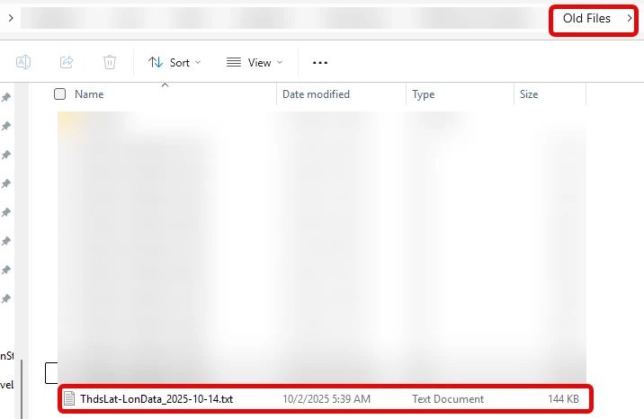

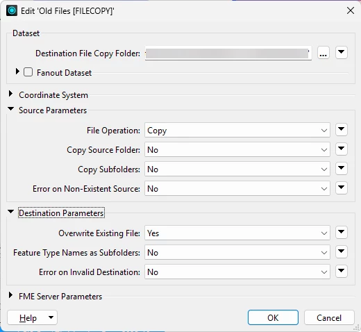

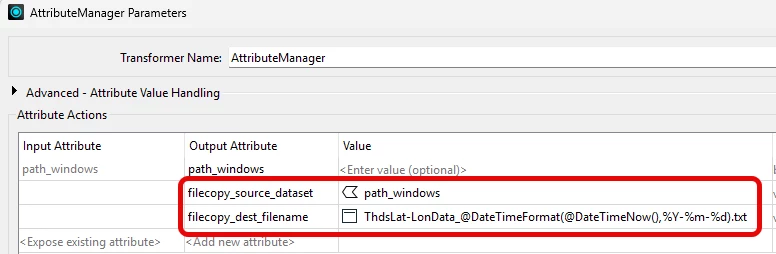

I know this is an older post but I was successfully able to accomplish a top level copy/move of a file.
I added an AttributeManger just before my Writer and added the two following attributes.
Set Writer parameters as follows:
       ** I want to Copy but the File Operation can be set to Move for a Move use case.
...and connected the attributes as shown here.
Result - No sub folder
Hope this helps others.
