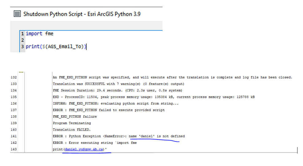

Hi Dan,
Thanks for your response.
Please see attached. It seems I can get the value from deployment parameter, but I do not know why I cannot even print it out. It seems I can manipulate the parameter in python. Would you be able to shed some light?
Thanks,
Daniel

In this case I think the error message is caused by missing double quotes in your print function.
Try print("$(AGS_Email_To)") instead. Hope that helps!

Thanks Dan. It worked in this way.
