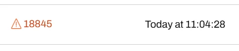

I have the same problem. FME Flow 2024.2 Build 24783 - win64
It doesn’t seem to be limited to the MS SQL reader:
47 2025-9-2 11:04:28 | Using Multi Reader with keyword `MULTI_READER' to read multiple datasets
48 2025-9-2 11:04:29 | Creating reader for format: Microsoft Access
49 2025-9-2 11:04:29 | Trying to find a DYNAMIC plugin for reader named `MDB_ADO'
50 2025-9-2 11:04:29 | Microsoft Access Reader: Read 5 DEF line(s). Found 120 attribute(s)
51 2025-9-2 11:04:29 | Microsoft Access Reader: Opening `....accdb' for read operation
52 2025-9-2 11:04:29 | Using MultiWriter with keyword `PRIMARY_DEST' to output data (ID_ATTRIBUTE is `multi_writer_id')
53 2025-9-2 11:04:29 | Writer output will be ordered by value of multi_writer_id
54 2025-9-2 11:04:29 | FME Configuration: Using FME Reprojection Engine
55 2025-9-2 11:04:29 | Loaded module 'XMLTemplaterFactory' from file 'C:\Program Files\FMEFlow\Server\fme\plugins/XMLTemplaterFactory.dll'
56 2025-9-2 11:04:29 | FME API version of module 'XMLTemplaterFactory' matches current internal version (4.0 20240212)
57 2025-9-2 11:04:29 | Microsoft Access Reader: Now reading features from table MetMan_T, 10 record(s) at a time
58 2025-9-2 11:04:29 | Microsoft Access Reader: An internal error has occurred. Please visit http://www.safe.com/support
59 2025-9-2 11:04:29 | Microsoft Access Reader: Failed to parse datetime, attribute set as null

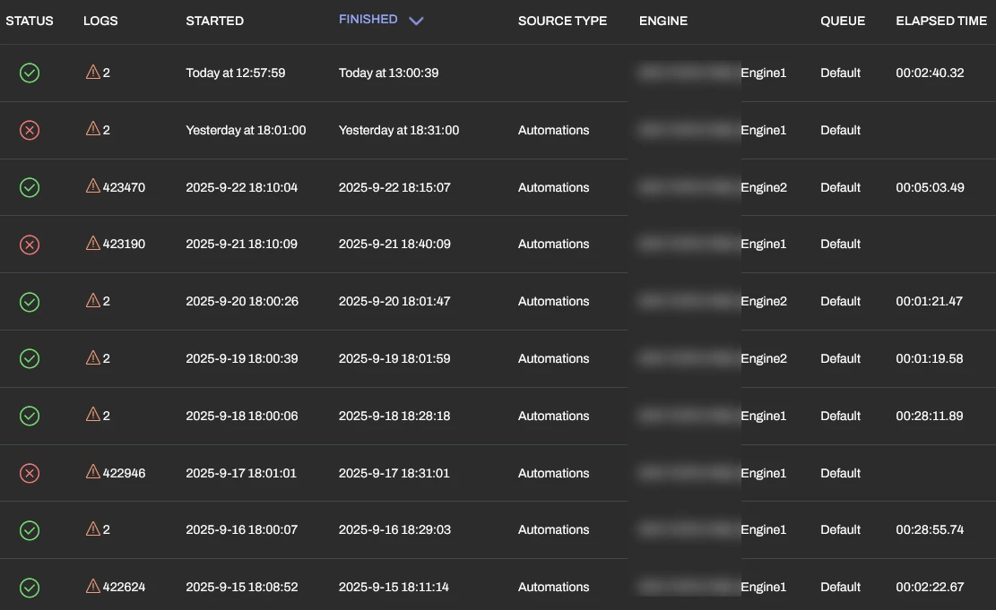

This problem will show up from time to time for me. One time it was so bad that the server ran out of storage space and crashed, too many and too big logs.
What usually solves it for me is to republish the workbench but the important part here is to reupload the connection that's messing up. FME will uncheck it be default since it’s already uploaded.

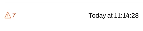

  • Sep 24, 2025 11:22 AM UTC
I feel like a quack doctor here, but sometimes you have to repeat the process a few times…
Also, that screenshot looks good to me(?)
I only see 2 warnings.
stezi
Forum|alt.badge.img+6
  • Sep 25, 2025 6:07 AM UTC

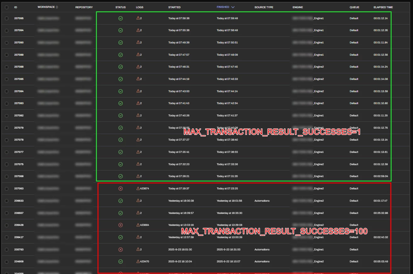

Each of the 42000 warnings logs the error “Failed to parse datetime, attribute set as null” / “An internal error has occurred,” which means that in this job run, the MSSQL_ADO Reader may not have loaded correctly.
When I set MAX_TRANSACTION_RESULT_SUCCESSES=10, the error still occurs, but when I use MAX_TRANSACTION_RESULT_SUCCESSES=1, it no longer occurs.
But I’d rather find a better solution since this is an option that needs to be set again and again every time that we upgrade FME.

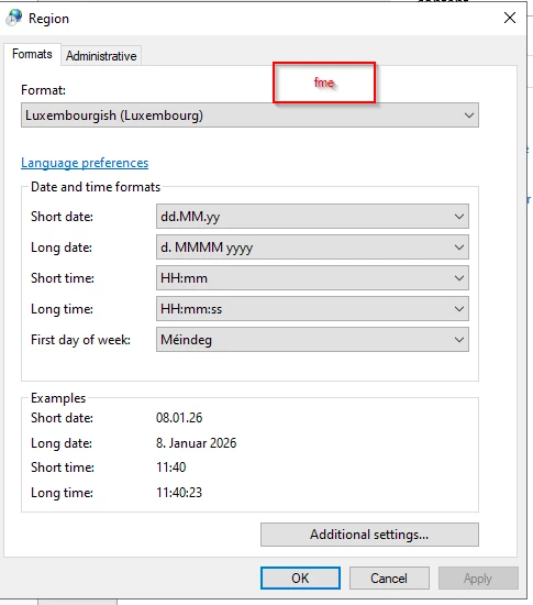

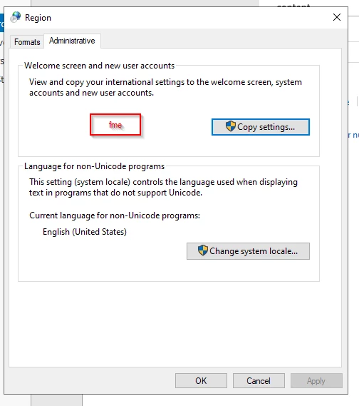

Changing the OS locale to English finally solved the problem.
