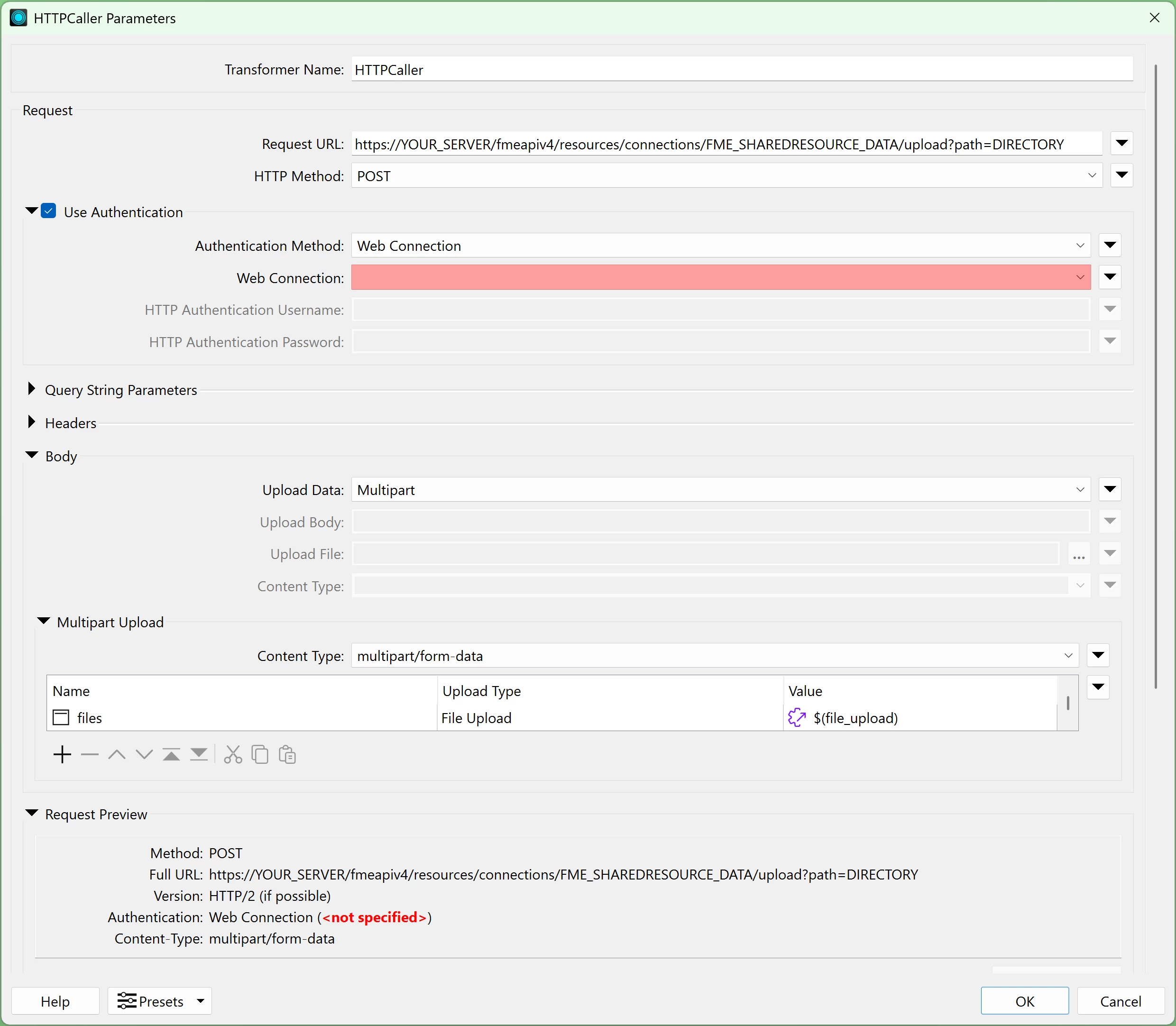

That being said, this is possible using a workspace app made from a workspace using a File/Folder/URL User Parameter and an HTTPCaller. The HTTPCaller should be configured as follows:
Here I’ve opted to have the user upload to a directory within Resources/Data, but this can be changed by specifying a different connection in the URL. It’s also possible to create a new Resource Connection.
Please let me know if you have any questions about this! I’d be happy to go into more detail if required.
